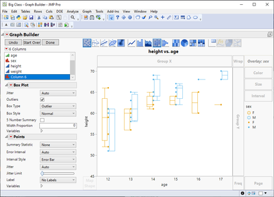

How can align the points inside their respective boxes in Box plot (when an overlay is applied)
i have a data where group x is one column lets say A , and on overlay there is another column lets say B .
Is there any option that the points can be aligned in their respective boxes?

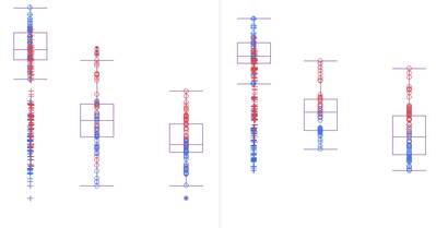

Re: How can align the points inside their respective boxes in Box plot (when an overlay is applied)
I tried that but it overlaps the two overlay variable boxes like below -
I was wondering if i can have them side by side as in the description of this issue ,along with the points inside their respective boxes.

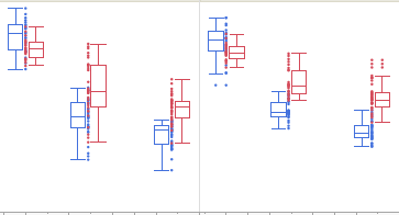

I tried this as well but it forms like this -

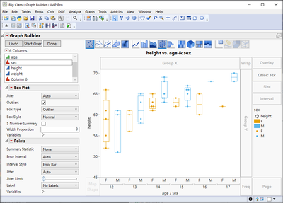

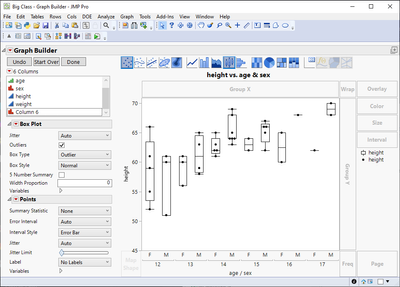

As I don't have your data I'm going with a bit of guessing based on your script. I won't have X Group in my graph, it might matter or not
We start from this
Then we move our overlay to X-Axis (you can hide the labels if needed)
And finally we add that same column to color
So we are not utilizing Overlay in this case which can be an issue with your data or with what you are trying to plot
