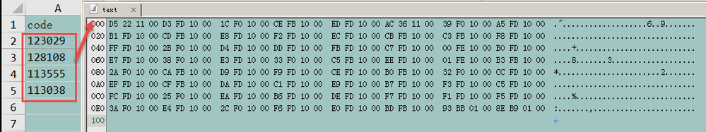

lwx228
Level VIII
Re: How can JSL modify data in a table directly to a specified binary file?
  • JMP is powerful
