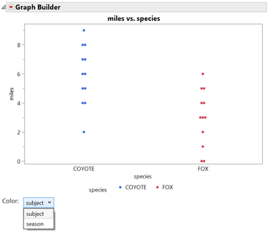

Hi,
I am trying to only display certain columns in the combo box as legends, but the current code I have takes the column one by one. Is there any way in which I can skip over certain columns?
For example, in this case, I only want :subject & :season in the legend list. Here's my code:

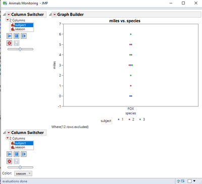

AbbWorld27
Level II
Re: How can I use the combo box to skip over certain columns for legend?

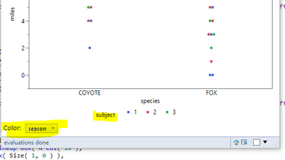

Hi Pauldeen, Thanks for your input.
My code is working, but if you click on season in the combo box, it doesn't change the legend.
The two combo options I have right now -
Click Species - It shows species as legend
Click Season - It shows subject as legend
whereas I want if you click species - it show species as legend and same for season. Hope that clarifies. Thanks!

AbbWorld27
Level II
Should have mentioned that I did try using the column switcher, but I also will be including another combo box in the tool
One combo box - for changing x-axis
One combo box - for changing legend/color
The column switcher isn't doing a good job at that, as it keeps on repeating for me.

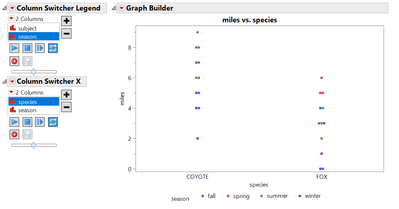

pauldeen
Level VI
Two column switchers look pretty good to me:

In this examples some clashes occur as they are using the same variable Season but that is handled gracefully with an error message and will probably not happen in your real dataset.
