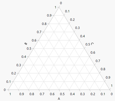

Dear JMP experts,
I am making a ternary plot in JMP and want to reverse all axes. Unfortunately, the reverse order option is blocked in this setting. Do you know how I can fix this?. Thank you in advance.

This request does not make sense to me. Consider an example like yours, but with the labels of A, B, and C for the components.
The very top vertex is A=0, B=1, and C=0. If I could reverse the B axis, the top would now be A=?, B=0, C=?.  What should A and C? They can't be zero anymore as A and C will need to add to 1. There are an infinite number of combinations. So, you want to show all of them, right? Well, that will be the very bottom of the graph where B is already at 0.
Ultimately, the ternary graph takes into account that the components add to 1. Reversing the axes would break that constraint.
Please explain further on what you are trying to do, as I feel that I am missing something.

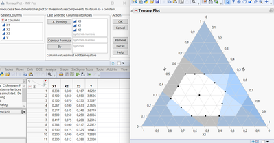

Here is the "standard order" and resulting Ternary plot :

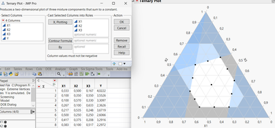

If I want to have X1 on the left, X2 on the right and X3 at the bottom, the order should be :
First variable is bottom axis, second one is on the left axis, and third variable is on the right.
