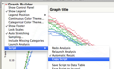

Perhaps I am simplifying your question, but for a few graphs, I simply do this:
9414_Screen Shot 2015-08-05 at 12.44.26 PM.png9414_Screen Shot 2015-08-05 at 12.44.26 PM.png
Then press "Shift + CMD + N" [In a Mac] to open a New Script Editor, and paste the script, then save the script on a master document for further editing.
There is also the option "Save Script to Data Table", also useful.

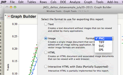

I would love to know if there is a way to export as ".jpeg", in File>Export, I only see the following options:9415_Screen Shot 2015-08-05 at 12.48.12 PM.png9415_Screen Shot 2015-08-05 at 12.48.12 PM.png

To add to this...It appears you're using JMP for Mac if you're Exporting. I'm using JMP for Windows which has a jpeg option, however it's under File>Save As not Export like on a Mac, an OS differenceI've found .pngs are pretty universal and highly beneficial if you need transparency, and is my go to graphic output.

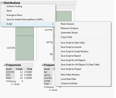

Hi Isabelle,
First you can find the script for each graph by clicking the red triangle associated with the graph produced. Or if the graph has already been produced by someone else and once it JMP, you should be able to follow the same procedure to access the scripts for each graph. In the example below, I used the animal sample data and ran a distribution analysis on animal species by season.
