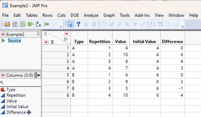

A more efficient method is to use a simple script to create a new table that contains just the initial values, and then merge the table back into the original table, where the matching will allow for the replication of the initial values to all of the matching records
names default to here(1);
dt=
New Table( "Example2",
	Add Rows( 8 ),
	New Column( "Type",
		Character,
		Set Values( {"A", "A", "A", "A", "B", "B", "B", "B"} )
	New Column( "Repetition",
		Numeric,
		Set Values( [1, 2, 3, 4, 1, 2, 3, 4] )
	New Column( "Value",
		Numeric,
		Set Values( [4, 10, 8, 7, 6, 9, 5, 10] )
// Create a table with the initial values
dt << select where(:Repetition == 1 );
initialDT = dt << subset( selected rows(1), columns({:Type,:Value}));
// Rename column Value to Initial Value
initialDT:Value << set name("Initial Value");
// Merge the values back to the original table
dt << Update(
	With( initialDT ) ,
	Match Columns( :Type = :Type )
// Create a column that contains the difference
dt << New Column( "Difference",
	formula( :Value - :Initial Value )

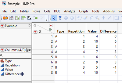

Matteo_Rotti
Level II
Re: How can I initialize my data wrt a fixed value?
Hi, thanks for the quick response. Sorry for my poor explanation but it is more complex to explain than, I hope, to solve.
I will try with a schematic table.
The goal is to get the “Initial Value” column, which has, for each measure, the value corresponding to the first repetition depending on the type of test, identified here as A or B. Then, with a simple difference I get the value shifted from the first experiment starting from 0.
The formula you saw in other message is my attempt to write the “Initial Value” column using an if condition with the number of repetitions, my problem is what to write in the other condition to get the same value for a different number of repetitions.
Thank you again
