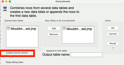

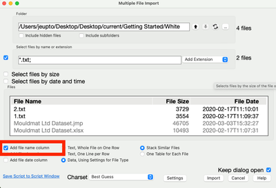

@fionaweston how are you importing these sheets? Multiple File Import has a checkbox to add file names to a column that is added to the final data table. You can create a similar data table column if you are manually concatenating files using the Concatenate platform. The file name for each imported sheet will be the title of the file which, based on your description, should include the file timestamp.

Multiple file Import has the feature I need and that you have highlighted (add a file name column, which I need because the name of each workbook contains the date ex "04/21 Metrics"). However when I use Multiple file Import will only give me back the first sheet of each workbook and I need the 3rd sheet in each of the workbooks. Is there a way that I can get the 3rd sheet from each workbook using Multiple file Import ? I have about 20 or so workbooks.
Conversely,
Using the File/Open, I can call the correct worksheet (sheet 3) from each workbook. So now I have 20 of the correct worksheet but I cannot tell which date they come from because this method does not have an option to create a source column.

Wendy's response shows a simple way to add the source column as the multiple file import creates.
Using Files in Directory() to get the files, and then a simple For() loop reading in one file after another, with each one adding the column like Wendy illustrated, is a very simple approach to use.
