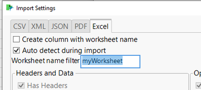

hogi
Level XIII
specify Worksheet for MFI:
delivered with JMP18:
hogi
Level XIII
@SpannerHead , to add a column with the worksheet name, use this option:
