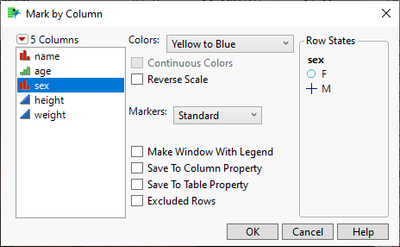

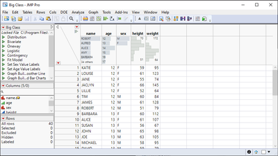

Blank Big Class
Setting markers/colors using Mark by Column

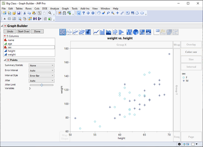

Graph builder
Graph builder with sex added to color

Jarmo,  I believe the OP is checking the box in your 2nd screen shot "Make Window with Legend".  This does create the legend, but it is not part of the actual plot (e.g., variability plot).  It is a separate window and in order to "print" it you have to journal it or clip it as the OP has been doing.  I do not know how to add the legend directly to the plot.

Most of the time with graph builder you might be able to get away by using Color or Overlay (depending on the plot).

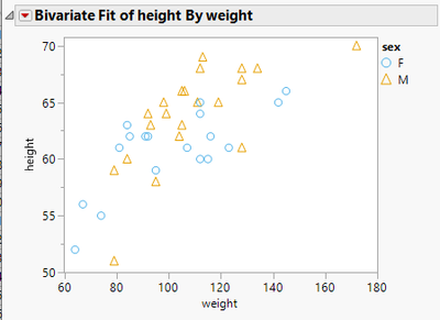

In some of the other platforms (not sure if this works in all of them) I think you have to start from those platforms and create legend there from right-click menu
