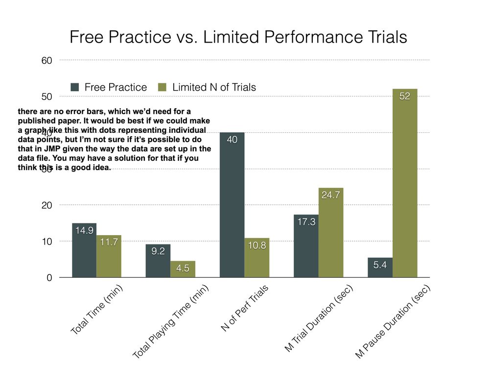

How can I create a multi-panel graph? JMP Pro 15
Hello community,
I need to put together several graphs from an existing data set similar to the one below. As the annotation says, I need error bars and dots representing individual data points for each. I'd appreciate any and all help in getting this to work and would be happy to Zoom with an expert that can walk me through on screen share.
Thanks!
Rick Palese

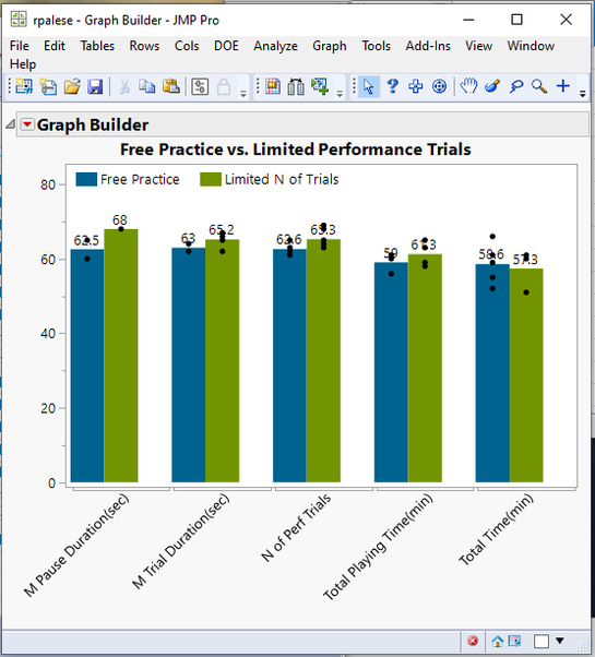

I interactively played around with some fake data taken from the Big Class sample data table.  This is the best I could come up with
I have attached the table I used for the development of the graph/chart.  I have embedded the script for the above chart into the data table.  Additionally, the script is also displayed below.
Note:  The maipulation of the data and the Chart Building was all done interactively.    Once it was done, I then extracted the script that generates the graph.

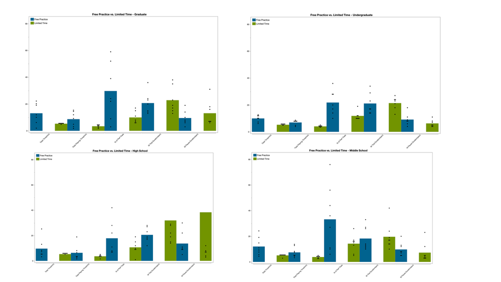

Gotcha. I've played around with your script and reformatted my data to fit your template. This all worked fairly well for one set of graphs:

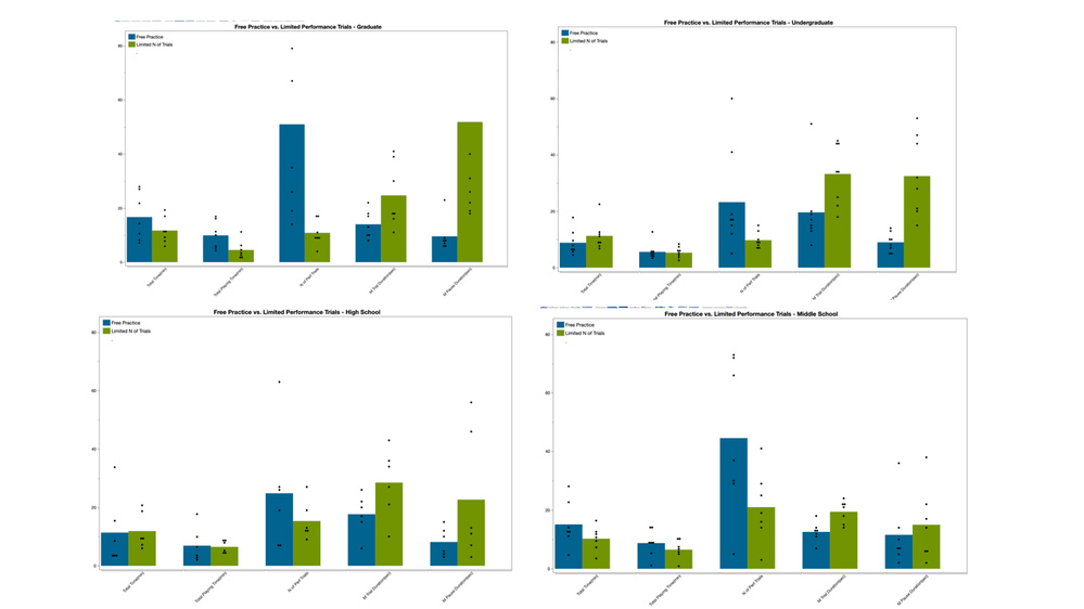

But didn't for another. Notice the space between the bars has shifted:
I've searched for a solution and investigated the script, but can't figure out how to manipulate this. Would you be able to help? Again, if a quick Zoom is easiest, I'm happy to coordinate a time. Thanks again for all your help!
