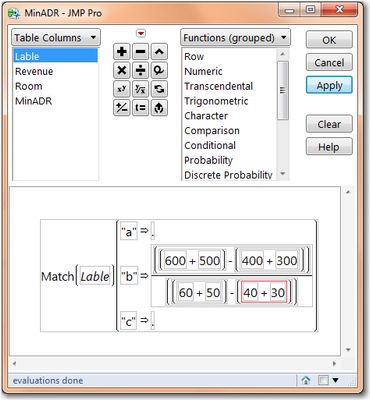

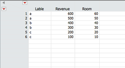

Dear Community, I need your help to calculate as a new column as MinADR of:
(600+500)-(400+300) / (60+50)-(40+30) placed in the row of Label "b"

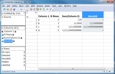

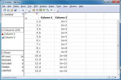

here's my table

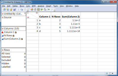

Here's Tables->Summary, Column2->Statistics->Sum, Column1->Group:

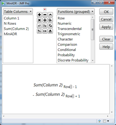

Add a formula column to the summary table:
Sum(Column 2) is a really ugly variable name, not a function call.
Getting close:

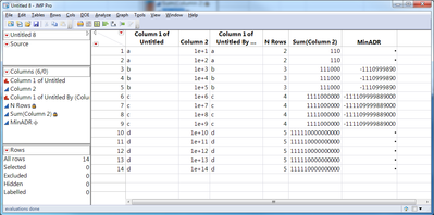

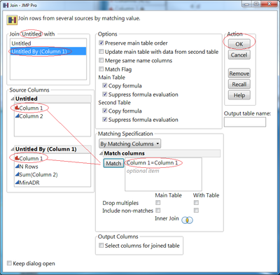

Tables->Join from the original, join with the summary, use the aabbbccc column to match the rows....
OK
Way back in the summary step you can summarize both of your columns at the same time; I've only shown the numerator columns here.  Renaming the columns along the way may help too.  The "source" scripts from the intermediate tables might be useful as well if you need to script this for multiple runs.

Dear Jeff,
I solved the problem by creating summary tables adding columns adding formulas to columns and calculating the desired variables. I was wondering if I was able to solve the equation without creating new summary tables. The question is:
Am I able to calculate in a new column the the (subtraction of ColSum of Revenue by one Variable of Label from another) and divide it by the (subtraction of ColSum of Rooms by one Variable of Label from another)..

Thank you Kevin,
This would solve the simplified example data table but actually the real data table consist of 600.000 rows of a, b and c
