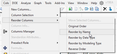

you can reorder the columns "by name" via the Cols menu:

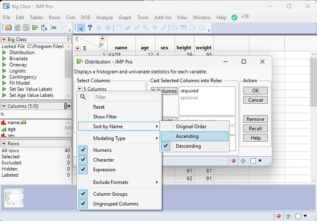

 It should also be noted that when using a selection box for any of the JMP Platforms, such as Distribution, Fit Y by X, etc. the column list in the dialog box allows for the ascending and descending ordering of the column names for selection

Dear @hogi
This works. Thank you for your support.
