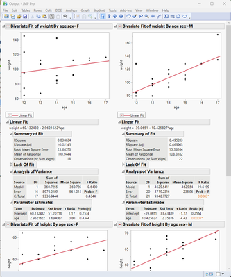

I checked the Scripting Index, and Fit Group does not appear to support the LineUp Box().  I believe you will get what you want, if you just replace
Fit Group(
with
nw = New Window( "Output",
the results will be displayed in your 2 columns
Names Default To Here( 1 );
dt = Open( "$SAMPLE_DATA/big class.jmp" );
	Lineup Box( N Col( 2 ),
		Bivariate(
			Y( :weight ),
			X( :age ),
			By( :sex ),
			Fit Line( {Line Color( {212, 73, 88} )} )
		Bivariate(
			Y( :height ),
			X( :age ),
			By( :sex ),
BTW, if you click on the JSL at the top of the Discussion Entry, and then cut and paste your JSL into the JSL Entry Window, the code is displayed in a more readable form for the Community Members

Here is a simple method to align the output.  It does assume that there are data at each x and y combination
		bivariate(
			y( :height ),
			x( :weight ),
			by( :age,:sex  )
Jim
Fit Group(
with
		Bivariate(
			Y( :weight ),
			X( :age ),
			By( :sex ),
		Bivariate(
			Y( :height ),
			X( :age ),
			By( :sex ),
