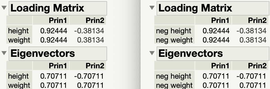

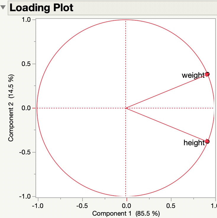

While you consider my request for clarification, here is another illustration of my previous answer. I am using the Big Class data table in the sample data folder. Here are the loadings from the PCA of the two continuous variables, height and weight:

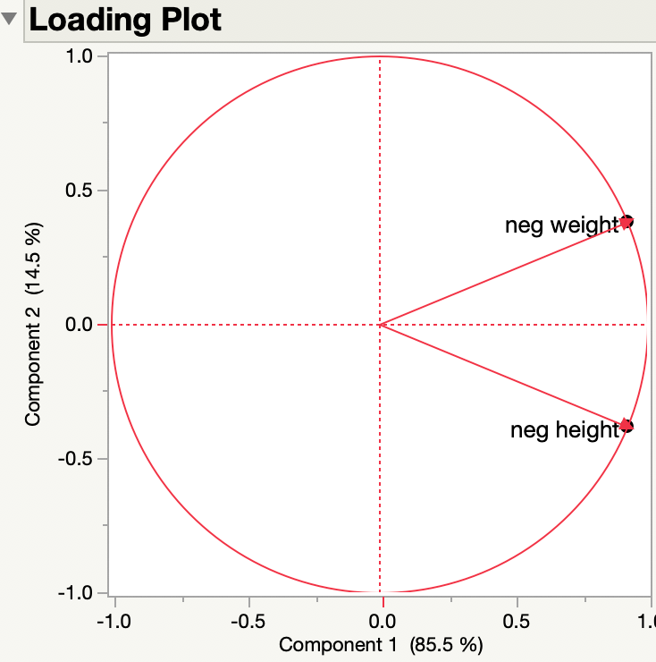

I multiplied both height and weight by -1 and created neg height and neg weight, respectively. Here are the loadings from the PCA of the two continuous variables, neg height and neg weight:
They are the same.
So the sense (negative or positive) of the original variables doesn't matter to the loadings. Here are the side by side results of the original variables and the negated variables:
The principal components represent new dimensions or axes that do not necessarily convey the sign or direction of the original variables.

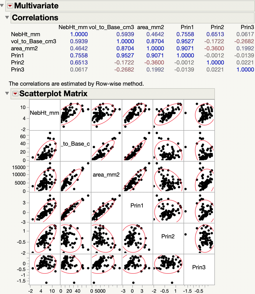

I assume that the 3 continuous variables were used to create the components. My results are similar but do not agree. Where did the components here come from?
Here is the picture for the 3 continuous variables and the 3 principal components.
So Prin1 is positively correlated with area, vol to Base and NebHt, in decreasing correlation. So the three original variables together capture the size of bedforms?

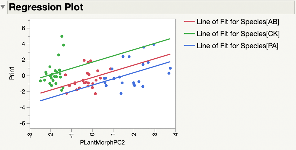

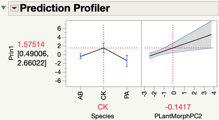

I used the linear model PC 1 = intercept + Species + Plant Morpho PC + Species * Plant Morpho PC. Is that what you mean by "if you do an ANCOVA?" I decided that the interaction term is not significant and removed it.
I looked at the regression plot and the prediction profiler to understand the model.
I see that Prin1 is higher for Species=CK as you said. Did you expect no difference between Species?
Principal components find new dimensions that maximize the variation from the original variables (length, area, volume). This new response should make a difference among species easier to detect.
