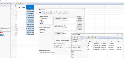

How I can graph many testing at the same time?
I exported  my data from excel to JMP table. I have many batches. Each lot have many different testing. I need to split the data by lot , I mean , every column is a  batch. I need in this format in order to do all the graphs at the same time .How can I sort the data?

You can use the Split platform (you'll find it under Table menu) ,
please refer to the help:
Split Columns (jmp.com)
