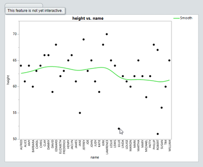

Hovering over data point in Interactive Html, I am expecting to see label data come through but it is not working as expected.

Thank you Mark. Tried your suggestion in Jmp 12.2.0 but I see no difference. Hovering over data point in HTML only shows 'This feature is not yet interactive' message.

It was added after JMP 12.
Re: Hover label on data in Interactive HTML not working
That's correct. We didn't add Interactive HTML support for Graph Builder until JMP 13.
Interactive HTML support expands in every release of JMP. For any version of JMP, you will get a warning when you export or save as Interactive HTML when there's something in the report that is not supported yet. The warning will tell you to look in the log to find more details.

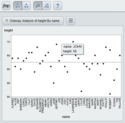

For a graph that plots Big Class student's heights by name,  in JMP 12, you could get Interactive HTML output by using the 'Fit Y by X' or 'Oneway' platform.
Names Default To Here( 1 );
nw = New Window( "Test Hover Label",
	dt << Oneway( Y( :height ), X( :name ) );
nw << save Interactive HTML( "$TEMP\test.html" );
Open( "$TEMP\test.html" );
Instead of a smoother, you will get a Grand Mean line.
