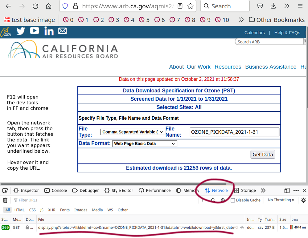

Yes, the developer tools make this easier than learning HTML Forms.
Using web browser developer tools to examine the link that was used to download a file
The link has parameters, which you can modify with JSL before opening it with open(). FF shown above, chrome is similar, but arranged differently.
Your original link requested 12 months of data. The site did not want to send that much, I stopped at 31jan instead of 31dec.
