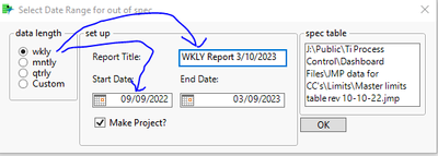

Hello everyone,
I was hoping someone could help me with this script.  I would like the start date and the report name to update based upon what radio button is selected:

Re: Help with updating a text edit box based upon a radio box selection
So solved my own problem!  Good old scripting index for the win.
I had to move the if statement into the radio box and then use the "set" commands to send updated info to the text edit boxes.  Hope this helps someone in the future.
							rb = Radio Box( {"wkly", "mntly", "qtrly", "Custom"},
											rbstate=rb<<Get Selected;
											if(rbstate=="wkly",
													teb<<set text( "WKLY Report "||char(Abbrev Date(today())) );
													nebs<<set(Today() - In Weeks( 1 ));
											if(rbstate=="mntly",
													teb<<set text( "MNTLY Report "||char(Abbrev Date(today())) );
													nebs<<set(Today() - In Weeks( 4 ));
											if(rbstate=="qtrly",
													teb<<set text( "QTRTLY Report "||char(Abbrev Date(today())) );
													nebs<<set(Today() - In Weeks( 13 ));
											if(rbstate=="Custom",
													teb<<set text( "Cust. Report "||char(Abbrev Date(today())) );
													nebs<<set(.);
