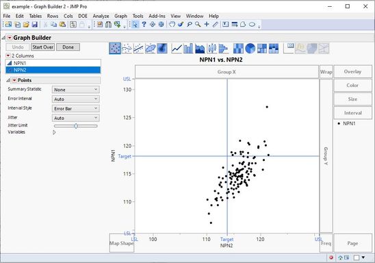

If you have your spec limits saved as column properties, and have indicated to "Show Limits", Graph Builder will automatically expand the axes range to include the USL and LSL.
However, you can easily override the axis values, as shown below, where the maximum X axis value is changed to the USL plus 10% of the range of USL-LSL
Here is the simple script
names default to here(1);
// Open Data Table: semiconductor capability.jmp
// → Data Table( "semiconductor capability" )
dt = Open( "\Example.jmp" );
// Change column property: NPN1
Data Table( "Example" ):NPN1 << Set Property(
	"Spec Limits",
	{LSL( 104.41 ), USL( 131.89 ), Target( 118.15 ), Show Limits( 1 )}
// Change column property: NPN2
Data Table( "Example" ):NPN2 << Set Property(
	"Spec Limits",
	{LSL( 96.59 ), USL( 130.9 ), Target( 113.75 ), Show Limits( 1 )}
// Report snapshot: semiconductor capability - Graph Builder
gb = Data Table( "Example" ) <<
Graph Builder(
	Variables( X( :NPN2 ), Y( :NPN1 ) ),
	Elements( Points( X, Y, Legend( 3 ) ) )
// Set Maximum  Y axis value to be displayed
specs = dt:NPN1 << get property( "Spec Limits" );
maxY = Max( Col Maximum( :NPN1 ), specs["USL"] + .1 * (specs["USL"] - specs["LSL"]) );
Report( gb )[AxisBox( 2 )] << Max( maxY );
