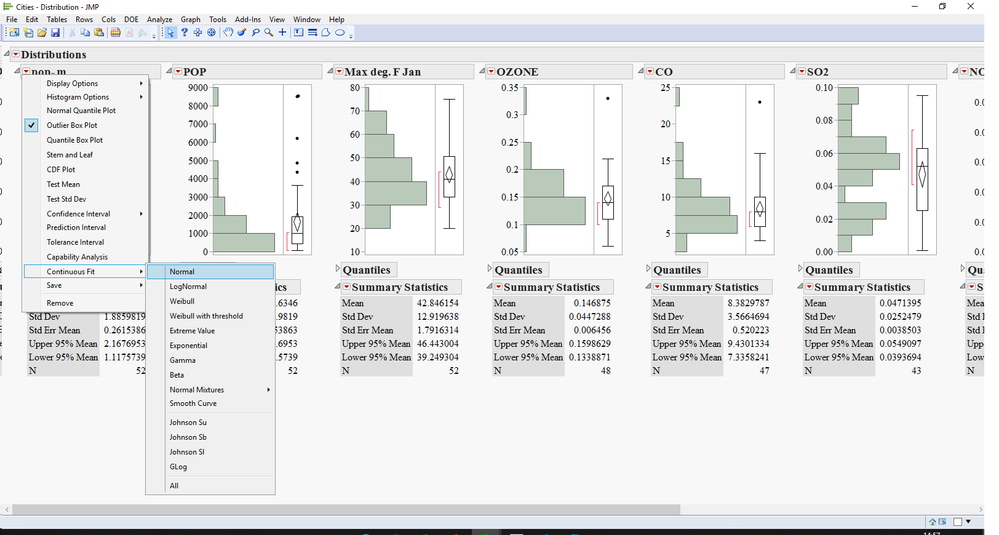

in this case you may want to try the following steps:
1) open your data table.

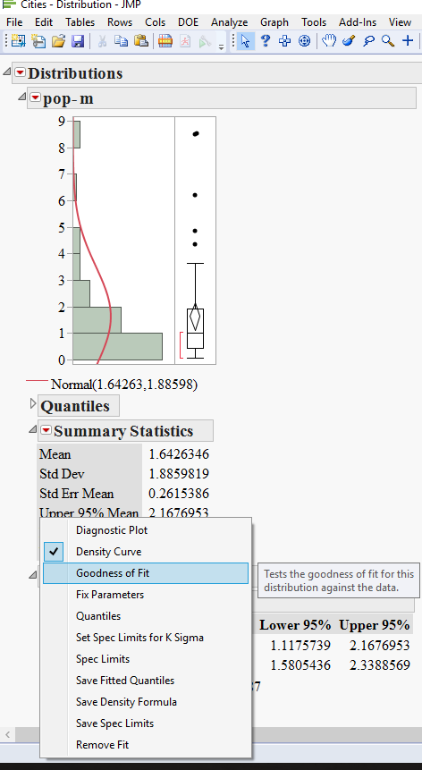

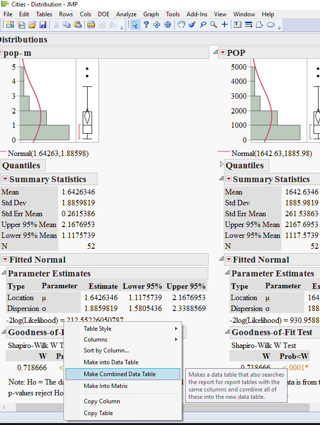

2) run a distribution with all the variables you want.
3) hold the Ctrl key and fit the normal distribution to all variables
4) hold the Ctrl key and get the goodness of fit
5) now comes the trick: right click on one of the goodness of fit tables and choose Make combined data table.
now you should have a fully functional table with all your results at once. this will allow you to sort by the statistic value or Pvalue or even make a graph of what you just got.
