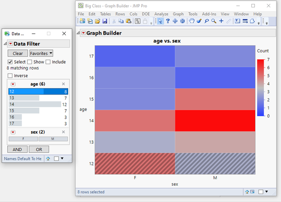

A script could be written to do what you are looking to have displayed to the user.  However, short of that, the closest built in item I can think of is to use a Data Filter, and set it to just select the data that are chosen.
Jim
