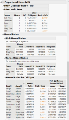

  I'm not entirely sure how to do this, as it's not something that I would normally work with, however what I think you're wanting to do is something similar to what is shown in the JMP Clinical online help, here. If so, and you don't have Clinical and using Pro, then after you do your Proportional Hazards Fit, in your Hazards Ratios for Unit or for a categorical variable, I would right click that table in the report and select make into data table.
The below is an example from the JMP sample data, VA Lung Cancer.jmp file.

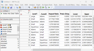

  Right clicking the Hazard Ratios for Cell Type and selecting make into data table gives you the following table:

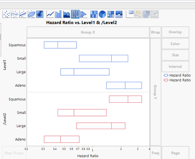

  And then you can use Graph Builder to create your Hazards Ratio plot:
  At least conceptually this is similar to the JMP Clinic help page from above.

Here are some additional tips to make it similar to what one sees in JMP Clinical if that is what you are looking for.
  1. Put the Upper and Lower in the interval zone and use custom interval for Error Interval type.
  2. Create a significance flag column and use that for color.
  3. Change marker to a simple vertical rectangle chosen from right clicking on the legend to the right. X axis is in log scale
  4. Add reference lines in the X axis by double clicking on X axis numbers to get axis properties.
