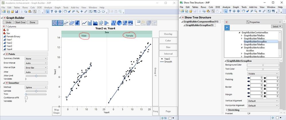

do you know how to get the GraphBuilderGroupBox "name" from the JSL scripting level? In attached picture it would be "Male" or "Female" (marked in red circles). My guess is to have a similar command to << xpath( "//GraphBuilderGroupBox" )) << Get Window Title. However it doesn't work.

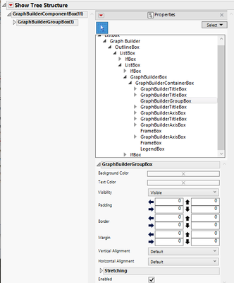

No sure if you can access those "names" (groupings) from graph builder. You can check what you can access with Xpath by using << Get XML on win variable and based on that there is no mention of "Female" and "Male". Also checking from Show Tree Structure and Show Properties I cannot see them there either:
