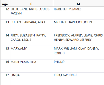

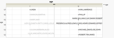

Hi, I know how to enable Labels for Heatmaps:the labels are nicely aligned with the heatmap cells and the values correspond to the column values which are used as color.
I also know how to enable labels for point plots - where the labels can be chosen independent of the "color" column:
Is it possible to combine both approaches:
Heatmap labels, where a column is used as labels which is NOT THE SAME as the column used for color?
Application case:
use a meaningful, normalized value as color [e.g. mortality rate] - but show the actual counts [e.g. Covid 19 victims] as labels.
Add-on question:  is it possible to use Character Labels?
e.g. a combination of
hogi_2-1698961442759.pnghogi_2-1698961442759.png   and   hogi_1-1698961330799.pnghogi_1-1698961330799.png
... something like:
so, similar to adding point labels to a heatmap plot, but with the text nicely confined to the heatmap cells?

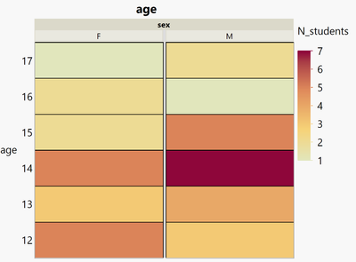

Graph Builder(
	Variables( Y( :age ), Group X( :sex ), Color( :N_students ) ),
	Elements( Heatmap( Y ) )

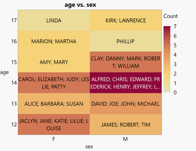

With some cheating (manually adding some linebreaks in the table), the best I can offer at the moment:
a combination of heatmap and points.
... unfortunately with the labels placed somehow arbitrarily
There is an entry in the wish list to solve such issues, but unfortunately it got archived :(

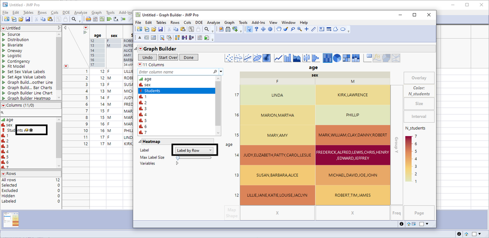

What a wonderful day - it's already there :)
Quite hidden feature!
The labels don't change when rows or columns get added as labels,
The labels just update when the user switches back and forth the label setting.
hogi
Level XIII
Re: GraphBuilder Plot: Labels?
So, actually
Names Default to Here(1);
:name << Label( 1 );
Graph Builder(
	Variables( X( :sex ), Y( :age ) ),
	Elements( Heatmap( X, Y, Label( "Label by Row" ) ) )
... will do the job.

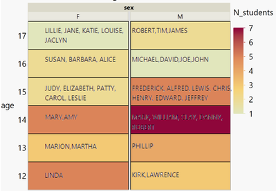

Is there a setting to get the entries separated by newlines instead of semicolons?
jthi
Use the earlier script you did use and use \!N as separator
Names Default To Here(1);
dt << New Formula Column(Operation(Category("Distributional"), "Rank"), Columns(:height), Group By(:age, :sex));
dtsplit = dt << Split(Split By(:"Rank[height][age,sex]"n), Split(:name), Group(:age, :sex), Remaining Columns(Drop All));
dtsplit << Combine Columns(columns(:"1"n, :"2"n, :"3"n, :"4"n, :"5"n, :"6"n, :"7"n), Column Name("Students"), Delimiter("\!N"));
//dtCombine << get name;
dtsplit << New Column("N_students", Formula(N Items(Words(:Students, "\!N"))));
Column(dtsplit, "Students") << Label(1);
gb = dtsplit << Graph Builder(
	Variables(Y(:age), Group X(:sex), Color(:N_students)),
	Elements(Heatmap(Y, Legend(1), Label("Label by Row")))
-Jarmo

1:0 for JSL vs. GUI  :)
Delimiter("\!N")
