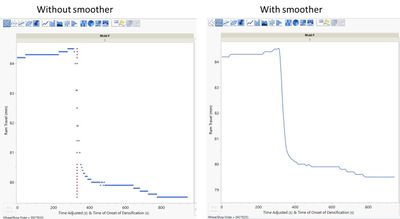

I have a graph with two different x-axes. I would like the graph to only use the smoother and not the actual values. However, when I turn on the smoother, the values for the second axis disappear (red values). Is there a way to prevent this from happening? Please see the attached image for an example of what I am talking about.

I see one of two ways to get what you want.

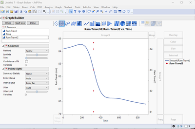

First method is to change your data to where you have 2 columns for your Y axis.  One column for each of Ram Travel for your smoother and one for Ram Travel for your Onset time.  The Rows in the table do not overlap.  There is either data for the actual Ram Travel data or for the Ram Travel data for the offset, but not both
You then create the chart with Time on the X axis, and both the Ram Travel, and Ram Travel2 for the Y axis.
The Y axis is then split into a Left and Right axis.  This will then allow you to treat the two sets of data independently.  Leaving the right axis as points and the left axis as a Smoother
The second method, is to just add a Reference Line to your X axis for the Onset reference point.  If it is a static value as shown in your example chart, then this method might be a better way to handle your display

Shifting the one set of values to a new axis does allow for the visualization, but if I do that, then I can’t use the secondary axis for another factor. Attached is an image of the graph with a secondary factor that I already had planned on including in the graph.
The reference line isn’t really a good option because I have a lot of these graphs and each one has different point for the red data points. It is always a line and doesn’t change over time, but the value for it changes depending on the batch. Attached is an example of the graph with two y factors.
