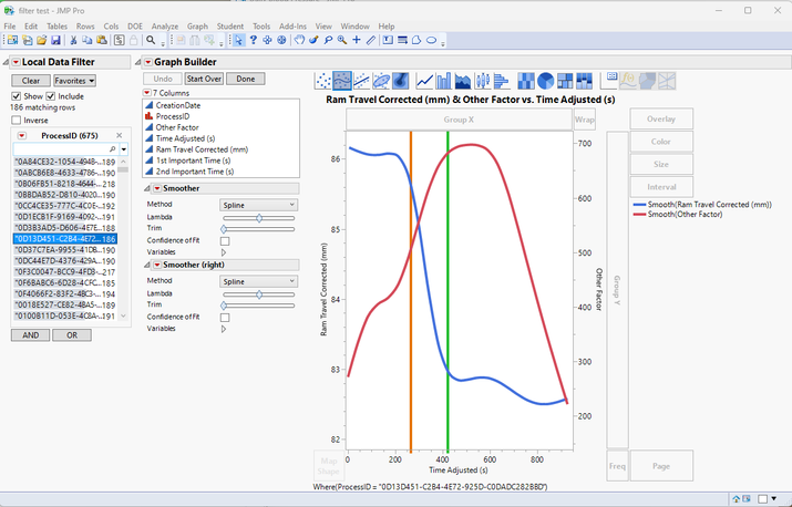

txnelson
Re: Graph with two x-axes
I have been able to modify your code to display the data as a smoother and the 1st and 2nd Important times as reference lines.
The JSL uses a Make Row State Handler to determine the Local Data Filter has changed, and then finds the correct 1st and 2nd Important Time data, removes the old reference lines, and then adds the new reference lines.
