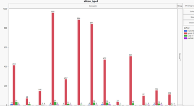

I tried to show the following data using graph builder,
I need to display the % of every type in regards to the Overlay.
for example-
the type as 10 full, 10 partial, 10 low and 70 good-> I want the bar to show me 10% to Full/partial/low and 70% to good
right now when I change the summary statistics to % of total-> it display the % in regards to all x (and not 1 by 1)

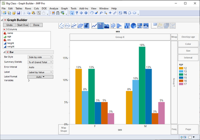

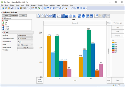

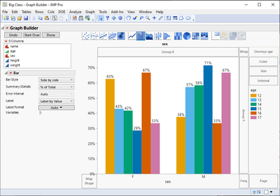

Have you tried the other summary statistic options?
N
% of Total
% of Factor (I think this is the option you want?)
% of Grand Total
