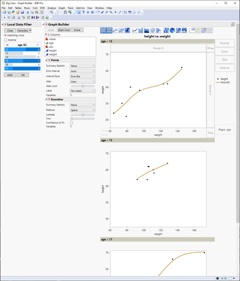

hogi
Level XIII
Re: Graph builder subset plots with the same axis labels
@Pandasgroupby wrote:
Using page, the window will be super long.
yes, a huge issue of "page"
- but it got fixed with JMP18:
Graph Builder - align 'pages' next to each other or as grid
So, for up to 30 or 100 products, it should be now OK via page - and much easier to handle than 30- 100 individual plots.

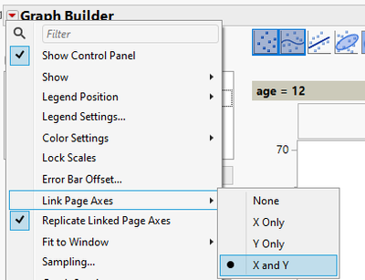

jthi
You might also want to consider using Local Data Filter, also remember to link axes
