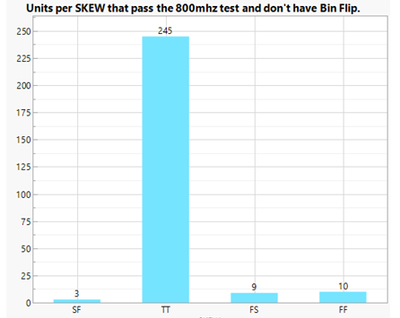

I would like to build a distribution graph through Graph Builder
I have 2 data percentages and a count
I can build separate percentages and count graph
but I don't know how I can merge this data on the same graph (percentage + count together)

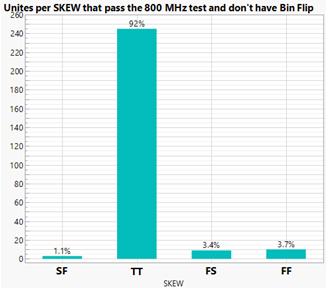

Hi,
If you have the counts and percentages data in two columns, select both and drag them on the Y-Axis zone. Then, right-click on the Y-Axis, and Choose "Move to Right" either the Counts or the Percentages. You can then format each (left and right) Y-axis to accommodate your needs.
