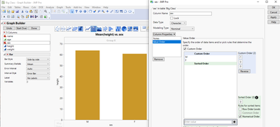

I have a graph, and I would like to move column "TYPICAL" to the middle of the graph.
I see there is an option "order by..." but I didn't find how I can manage the column by my choice.
Can you explain me where I can move the column?

Using Order By might or might not work and I would suggest using Column Property Value Order for this type of re-ordering.
By default:
after applying value order
-Jarmo
