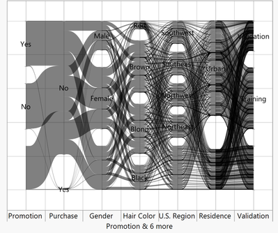

Please try Enhanced Sankey Plot (ESP)  , provided by @jthi .
This type of plot is useful to visualize correlations and root causes in the data.

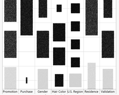

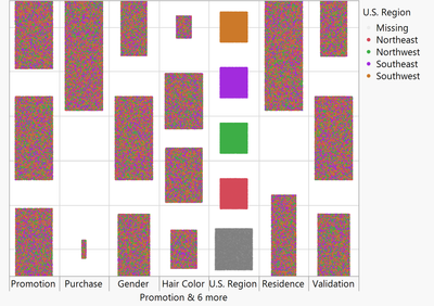

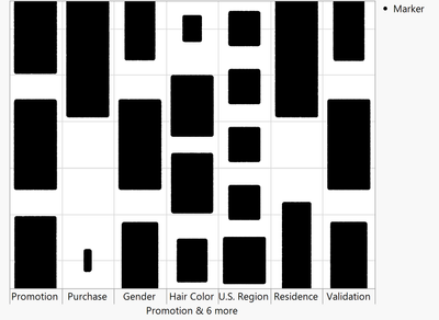

Unfortunately, if some of the entries have missing data, it's hard to distinguish between real "splits" - and accidental splits (missing vs. available data). This problem could be solved by increasing the transparency for missing data. Unfortunately, the only way I know how to selectively add transparency is: via the color dropzone. But due to the way the data is displayed in parallel, this is a dead end:
How can I generate a plot like this:
... or is there another, better  way to mark missing data?

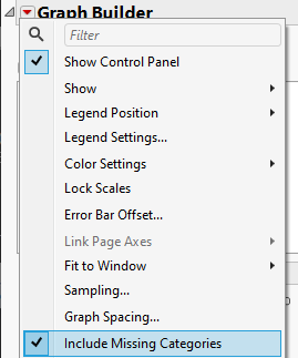

jthi
Re: Graph Builder - parallel Plot - missing entries
Maybe one option is to enable
-Jarmo
hogi
Level XIII
hogi
Level XIII
You mean "disable" - hide completely, instead of adding some transparency?
Agree, better than showing ...
