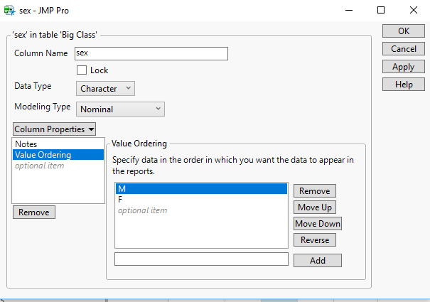

I'm trying to figure out if there is a way to reverse the order of the "group by x variables: high, low, natural" like is possible with the x and y axes.
Thanks!

Set the Column Property, "Value Ordering" for your X Grouping column.  It will allow you to change the ordering to any order you want.
Jim
