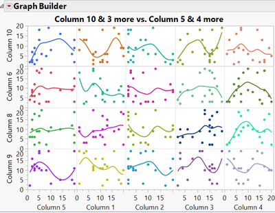

Hi @Dyan ,
Is the following graphic what you want to create? If so, here is a sample script.
x_vars = "";
y_vars = "";
xlist = {X, X1, X2, X3, X4} = Eval List( {colX[i], colX1[i], colX2[i], colX3[i], colX4[i]} );
ylist = {Y, Y1, Y2, Y3, Y4} = Eval List( {colY[i], colY1[i], colY2[i], colY3[i], colY4[i]} );
For( x_i = 1, x_i <= N Items( xlist ), x_i++,
	If( !Is Empty( xlist[x_i] ),
		x_vars = x_vars || "X(" || Char( Eval Expr( xlist[x_i] ) ) || "),"
For( y_i = 1, y_i <= N Items( ylist ), y_i++,
	If( !Is Empty( ylist[y_i] ),
		y_vars = y_vars || "Y(" || Char( Eval Expr( ylist[y_i] ) ) || "),"
Show( x_vars );
Show( y_vars );
Eval(
	Parse(
		Eval Insert( "\[GB = Current Data Table() << Graph Builder(
				Size( 621, 472 ),
				Variables(  ^x_vars^  ^y_vars^  ),
The following discussion page refers to a similar question. https://community.jmp.com/t5/Discussions/JSL-Script-Graph-Builder-to-plot-all-columns-of-a-data-tabl...
You can also learn about expressions on the page below. https://community.jmp.com/t5/JSL-Cookbook-Archived/Insert-one-expression-into-another-using-Eval-Ins...
I hope it helps.
