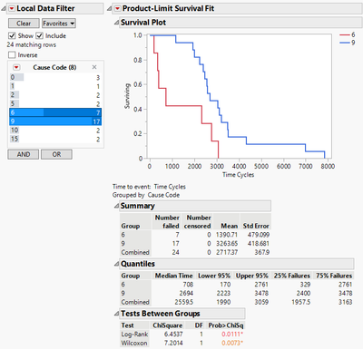

I think that you at least need the Local Data Filter feature in JMP to help you to get pair-wised comparisons. Here is a screenshot to illustrate. There are 8 groups in the data, I can pick any two groups to compare using the Local Data Filter.
If you are interested in multiple-comparisons, then these two resources are relevant: Multiple Comparisons Problem and Bonferroni Correction . In a summary, you need to adjust your confidence level based on how many simultaneous hypotheses you have. And your hypotheses are those pair-wised tests.
