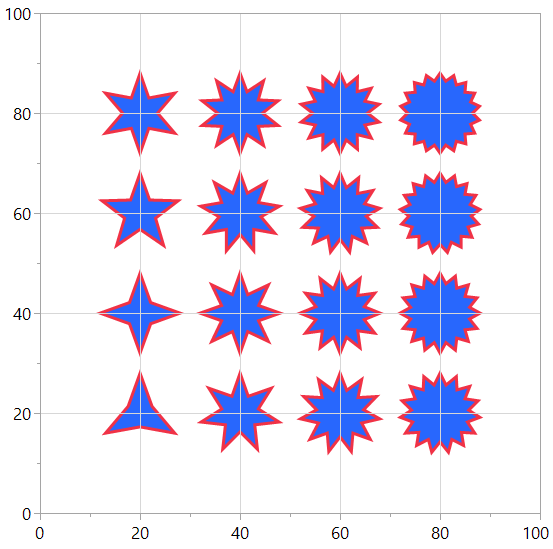

N-pointed starsN-pointed stars
makestar = Function( {x, y, npoints, inside, outside},
	{p = J( 2 * npoints, 3, . ), angle, i, move = 1, draw = 2},
	For( i = 1, i < N Rows( p ), 0,
		angle = 2 * Pi() * i / N Rows( p );
		p[i, 1] = x + Sin( angle ) * inside; // sin and cos are reversed here to
		p[i, 2] = y + Cos( angle ) * inside; // make the point be at the top.
		p[i, 3] = If( i == 1, move, draw ); // swap sin/cos for point at left.
		i += 1;
		p[i, 1] = x + Sin( angle ) * outside; // ditto
		p[i, 2] = y + Cos( angle ) * outside;
		p[i, 3] = If( i == N Rows( p ), -draw, draw );
		i += 1;
	p; // return
New Window( "Example",
	gb = Graph Box(
		xaxis( Show Major Grid( 1 ) ),
		yaxis( Show Major Grid( 1 ) ),
		framesize( 500, 500 ),
		Pen Color( "red" );
		Pen Size( 3 );
		Fill Color( "blue" );
		npoints = 3; // each star gets more points below
		For( xx = 20, xx <= 80, xx += 20,
			For( yy = 20, yy <= 80, yy += 20,
				// the inside/outside ratio needs to change with more points...
				p = makestar( xx, yy, npoints, 2 + npoints / 4, 8 );
				Path( p, 1 ); // blue solid fill
				Path( p, 0 ); // red outline
				npoints += 1;
// move the grid lines above the stars
grid = gb[framebox( 1 )] << find seg( SegPlaceholder( 1 ) );
// grid is the original, below the stars
gb[framebox( 1 )] << appendseg( grid ); // makes a copy above
// probably not needed...they are on top of each other...
grid << delete; // delete the original from below

path() function?
Bezier interpolation  and Bezier Tree using Path() (and the scripting index probably has simpler non-Bézier examples.)
Also the column property UseForMarker works on picture columns, but it sounds like you might not have a data point for each marker.
I think the only way you'll get pictures or icons without UseForMarker is to make separate picture segs for each marker. They can be positioned, seg-by-seg.
Craige
		i += 1;
		i += 1;
	p; // return
	gb = Graph Box(
		Pen Color( "red" );
		Pen Size( 3 );
				npoints += 1;
Craige

There is also a PixelPath() function. If you run into performance issues, with 1000s of points perhaps, PixelPath allows repositioning, sizing, and rotating an existing path. (I don't see how to do that with Path().) You could pre-create the star(s) once, then re-use them with PixelPath.
Path() and PixelPath() behave differently when you stretch the graph: Path draws in user coordinates and the drawing stretches to fit the current axes. PixelPath draws in pixels and the symbols don't change size.
The scripting index has an example for PixelPath; use PixelOrigin(x,y) and leave h,v at 0,0.
