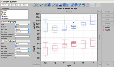

Problem: Create the graphbuilder plot below using the BigClass sample data set.
Select the 15 year olds as shown (screen clip).  I have my highlight preference set to 'make larger' on Mac.

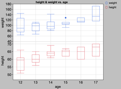

Click 'done' and then Command-C (copy) to copy the plot.  The paste into powerpoint:
The problem is that the data highlight is removed.  The same is true on my windows version to powerpoint on windows.  Is this a setting I need to change?  I thought I used to be able to do this?
Selecting data is a helpful way to draw audience attention in live mode and I'd also want this to be able to carry thru with passive (e.g. paste into powerpoint) mode.

Hello @datanaut ,
This is a possible workaround. I've tried this on my Windows OS (I haven't tried it on Mac OS).
- Right click on the graph and select Edit > Copy Graph.
Hope it works.

Thanks for your reply to my question.  This does indeed work for me on both windows and mac.
I'm curious if there are any other ideas out there where it could be a default or permit me to use the selection tool or Ctrl-C.  If none appear, I'll mark this as the solution.

I always copy just with the selection tool and paste using paste special> Picture (Enhanced metafile) and it works for me.
