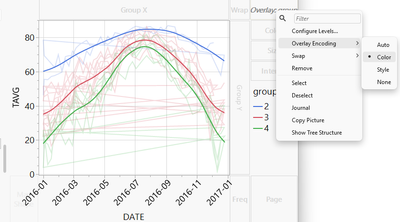

A nice improvement in JMP19 is the Type Properties() feature, which allows us to apply transparency much easier:
  • same group = same color
  • transparency via Type Properties - no need to set it manually for every curve.
  • each group has it's own smoother curve (overlay encoding = auto or color)
  • smoother curves with matching color
  • just the zig-zag lines need some extra effort *)
*) and this topic may be addressed in a future version of JMP:
https://community.jmp.com/t5/JMP-Wish-List/Graph-Builder-Line-possibility-to-add-breaks/idc-p/921029...
cool!

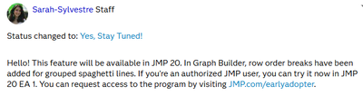

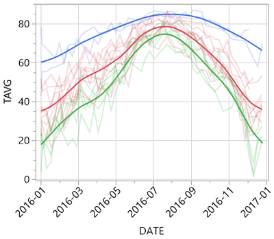

cool, JMP20 will bring a very easy solution for the issue with the zig-zag lines : Yes, stay Tuned!
dt =Open( "$SAMPLE_DATA/Functional Data/Weekly Weather Data.jmp" );
dt << New Column( "group",Character,"Nominal",Formula( Substr( :STATION, 8, 1 ) ));
Graph Builder( Variables( X( :DATE ), Y( :TAVG ), Overlay( :group ) ), Elements( Line( X, Y, Ordering( "Row Ascending" ) ), Smoother( X, Y ) ) );
hogi
Level XIII
Re: Graph Builder. Combine Smoother and Line - how?
It feels like a game changer for specific types of plots, such as grouped I-V curves.
