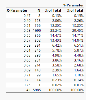

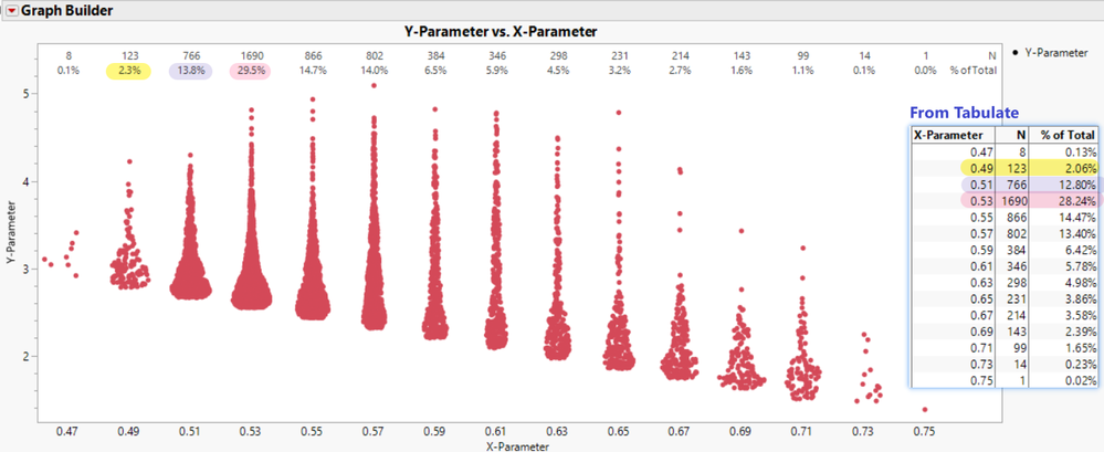

In graph builder, the Caption Box "% of Total" metric is not calculating correct values.
Values generated from Tabulate (inset below) are correct. I've highlighted just a few of the discrepant values.
Same result on JMP16.2 & JMP17.2.
know bug or something new? Can you please review?

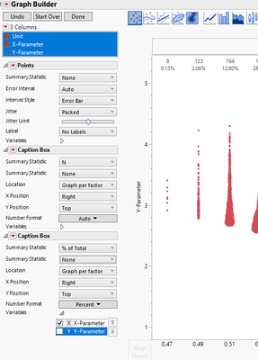

It is because you are returning the % of the total amount of Y-Parameter in graph builder vs the Qty of the X-Parameter vs the total number of rows in the tabulate.  If you add the Y-Parameter to tabulate you will see the difference.
In the caption box control panel turn off the caption box respecting Y (Y-Parameter) and you will get Graph Builder to match tabulate.

So not a bug but user error:flushed_face:, mis-understanding on my part of how "% of Total" works.
With y-parameter checked it appears to be: sum(y-parameter values, per factor)/sum(all y-parameter values);
With y-parameter un-checked its more like: N(values, per factor)/N(all values) - which is what I was looking for initially.
Thank you for the correction.
