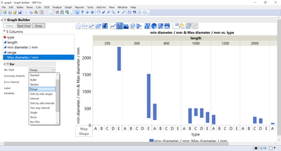

Hello everybody,
I would like to visualize data in a bar chart. I´ve got defined values for the start point and the range (length) of every bar. See files attached.
Is it possible to visualize data like that?

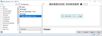

please find attached and run the script in the table.
one way of doing this is by introducing a new column with the formula :"min diameter / mm"n + :range
now you set the min diameter and the max diameter together on the Y axis. then you choose bars and select the range option
let us know if it worked,
ron

Thank you!
