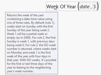

Re: Getting work week (WW) from "m/d/y h:m:s AM|PM" format
Just Open a new column in JMP and in the formula section find WEEK OF YEAR.
Week Of Year(date).
that's it....hope it helps.
And for "some" countries it is:
Calculating WEEKOFYEAR() for weeks that start on a day other than Sunday or Monday
