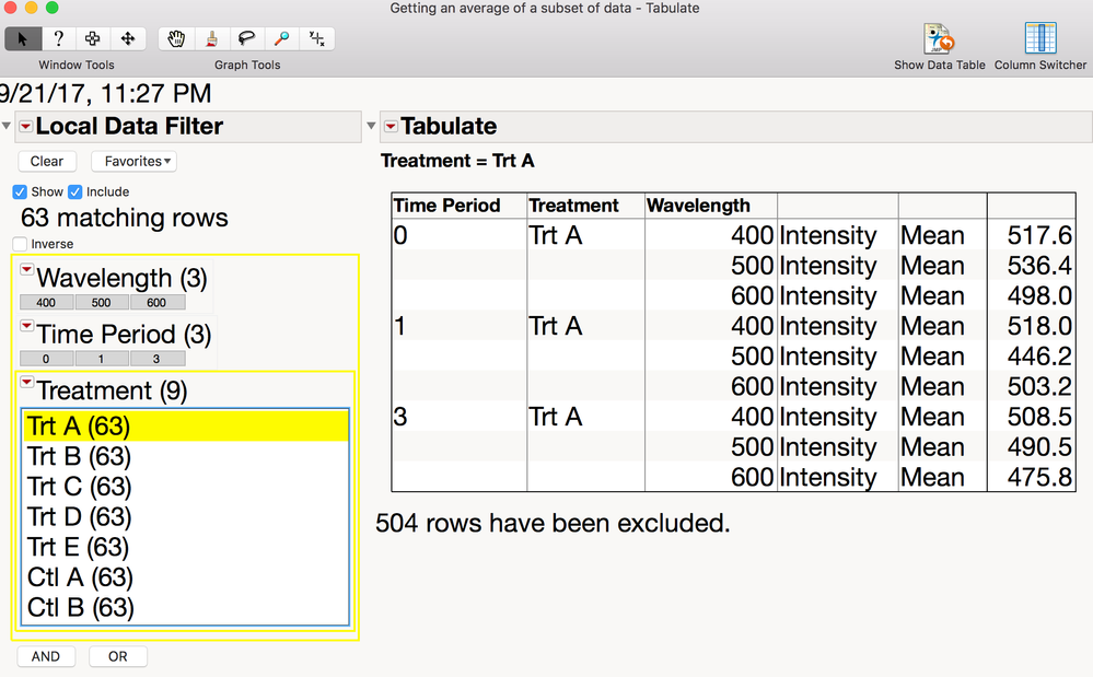

In the attached example data table, I saved two scripts to illustrate how you can do this using two different approaches.  The one entitled, "Mean by Trt and Time Period and Wavelength" creates a pivot table with a local data filter so you can look at the mean Intensities for various time periods, treatments and wavelengths.  The local data filter can be conditionally applied (by using "Conditional" under the red triangle option) so that when selecting a category it will limit the categories of the next column filter only to those that are in the selected category.
Tabulate (pivot table) with local data filterTabulate (pivot table) with local data filter

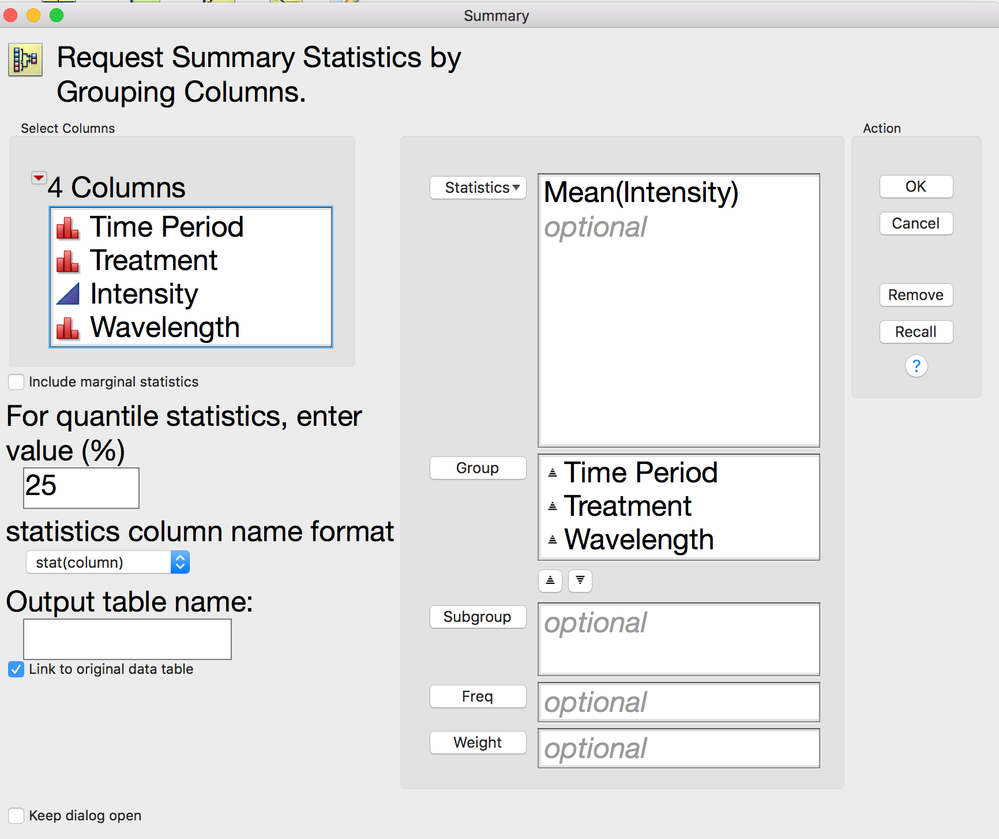

 The second script entitled, "Tables Summary" is an example of using the Tables-->Summary with the treatment, time period and wavelength as grouping columns.
Tables Summary Dialog with Group ColumnsTables Summary Dialog with Group Columns
