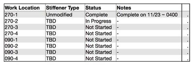

The best I could come up with was a blank column:
If you drag another measure (say mean) to the "N" column then you get missing data (as there is no mean to calculate). Then if you double click on the word "Mean" in the column heading you can change it to a blank.  So maybe this will work, maybe not, depends on your endgame (i.e., is it a tool for you or a tool for others).  Also, if you copy this table into word (or smoother document program) you could delete the column there.
