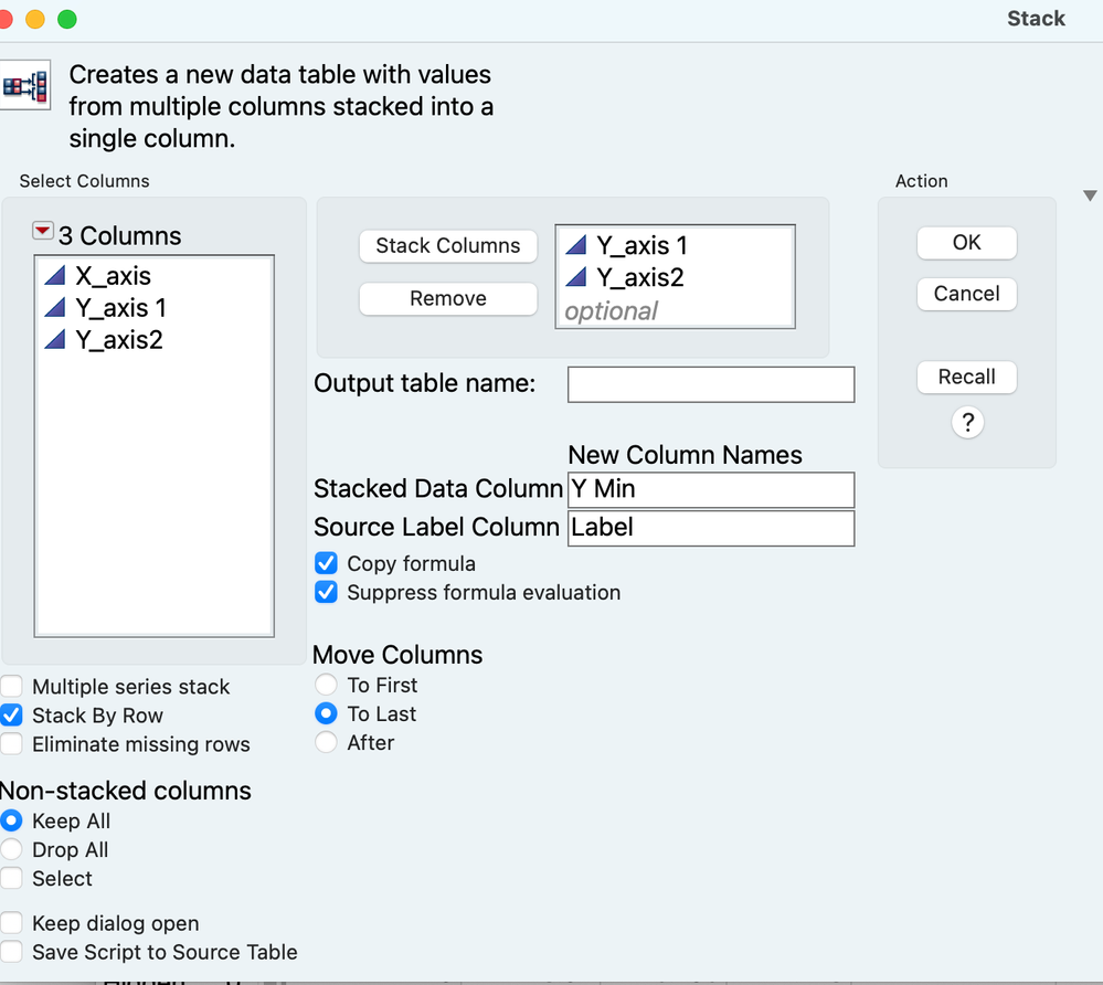

1) Stack the table: place the y columns into "Stack Columns", type "Y min" into the 'Stacked Data Column' text edit box. Hit OK.

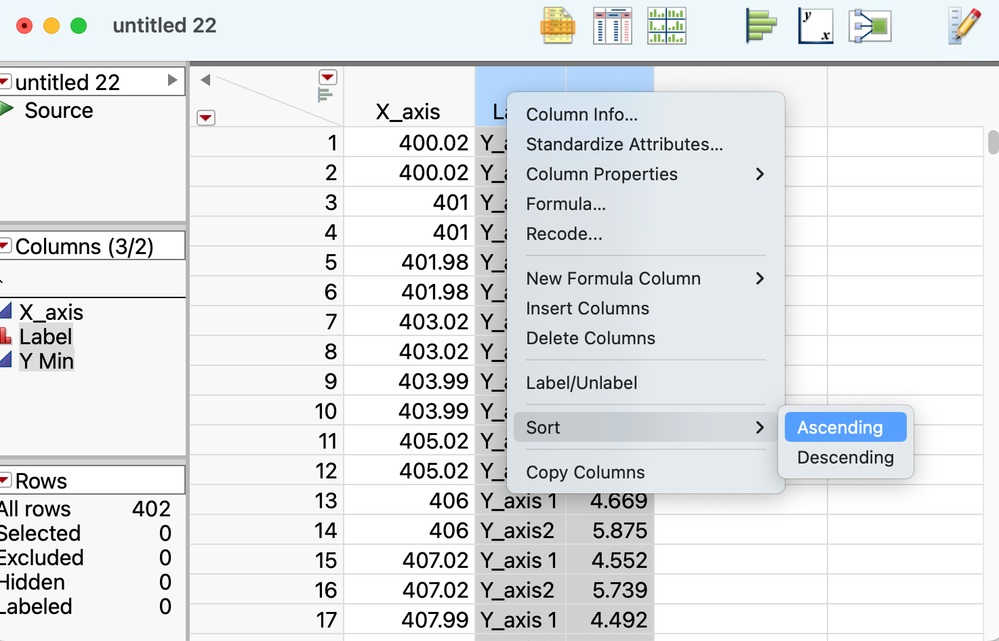

2) In the stacked table, select the Label  and Ymin columns, right-click on the blue-shaded column header, and select Sort > Ascending

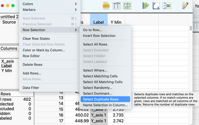

3) Select just the Label column, then select from the main menu Rows > Row Selection > Select Duplicate Rows

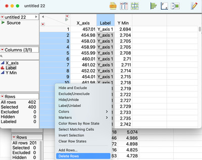

4) Right-click in the blue region of the selected rows and select Delete Rows

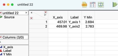

The resulting table has the desired summary info:
