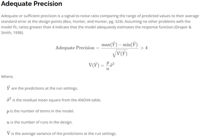

The "Adequate Precision" as displayed in Stat-Ease doesn't seem not a default calculation in JMP : Stat-Ease » v22.0 » Adequate Precision

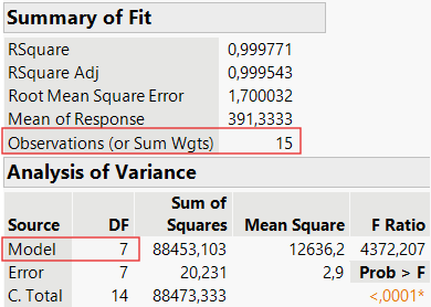

  1. Fit a model on the design points and save the number of terms in your model, and the number of points :

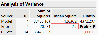

  2. Extract residual mean square (from "Analysis of Variance" tab) :

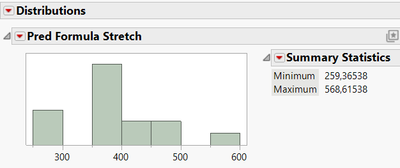

  3. Save Prediction formula on your table, and use "Distribution" platform to easily access min and max predicted values :
  4. You can then calculate the Adequate Precision of your model (in my case on this very clean/"ideal" dataset, it is equal to 156).
