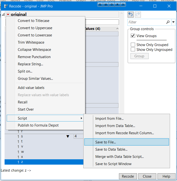

Also, you did not mention which version of JMP you are using. If you have recoded one table's 900 to 40 categories, depending upon your version of JMP you might have the option for Script > Save to File. Below is a screenshot of the option using JMP PRO v 14.2. The save script is attached.  You could run this script after opening each file and the recode column (in my script it is called orginal 2) will be created automatically.   However, I am not sure of the performance if you have extremely large files. (More discussion below).

I was able to save the script of the recoded column. Will try to run the script with another table and see if that works.
