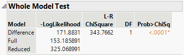

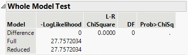

I do not think that AICc is valid when you fit the model with only the constant term. Here is the Whole Model Test for the model with X and the model without X.
With X
Without X
It doesn't make sense that the Reduced -LogLikelihood is so different because it should be the same model (intercept only). The large difference in AICc is due to this discrepancy. I do not think that it is due to the issue raised in the literature that you cited. That issue is about the earlier practice of computing a separate VIF for each model.

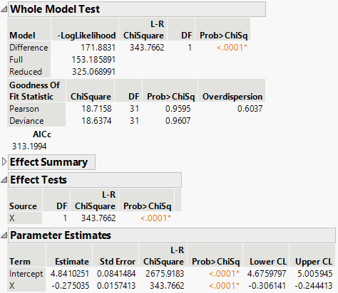

The Regression Plot and the Studentized Deviance Residual by Predicted plot show a good fit with X
You have a single regression, X. The inferential tests provided in the GLM should suffice to decide if X is important.
Conclusions:
  • The whole model is significant.
  • The term for X is significant.
  • Over-dispersion is not significant.
  • Lack of fit is not significant.

The AICc is useful information when selecting a model from among many model candidates. Are there more candidates that you did not present here?
With X
Without X
Conclusions:
