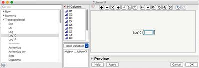

If I understand you correctly, this is quite easy.  Create the new column logX.  Create a formula for the column (right click on the column and select Formula).  In the left column select Transcendental and you will see log10 option.  Simply put the column you want to transform in the parentheses.

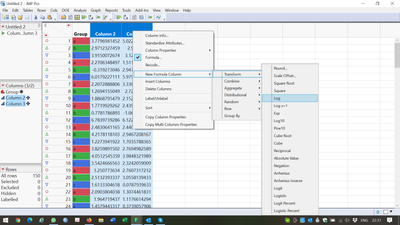

for me the fastest way would be to select the columns you want to transform right click them and follow the menu in the picture: New formula column >> transform >> log
you can do that to as many columns you select in one go.
