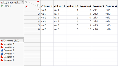

I have the following toy data table:
I have been having some trouble with refining a list of character column names becoming from the following script.

What I am getting is the following in the resulting modal pop-up window.
I want the following pop-up window only to have the following:
I think my problem may have to do with a gap in my knowledge of associative arrays that I am having some trouble understanding completely, even though what the JMP scripting guide says about associative array keys and the remove from, remove, loc, and contains functions make sense.
I want to make sure that the columns that are left in the resulting list that I used in the model window can be renamed by the user in the original dataset, so the column names that I want to remove will stay the same. Also, the arrangement of the columns in the data table is the same, but the associative array rearranges the values in ascending order.
