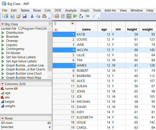

        May I ask why you are thinking about a column formula ? If you look at the example shown here, there are 4 rows selected in this data table. No matter where you check in your column formula, it will say "4" unless you want to do a cumulative sum of selected rows  so it would go gradually from 1 to n.
