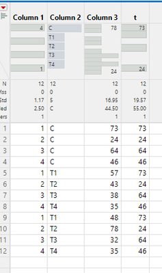

Col At() was added in JMP19 and it allows you to look for values of specific indexes within groups. So you can use that if Control rows are always before Tests (Column 3 is Result and Column 1 is Group)
Col At(:Column 3, 1, :Column 1)
Scripting Index has more examples.
